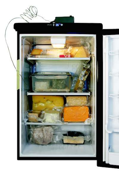

The cave’s job is to maintain steady temperature and humidity. Depending on the cheese style, the ideal temperature and humidity fall between 45°F and 58°F (7°C and 14°C) and between 80 percent and 98 percent, respectively.

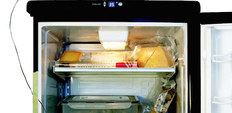

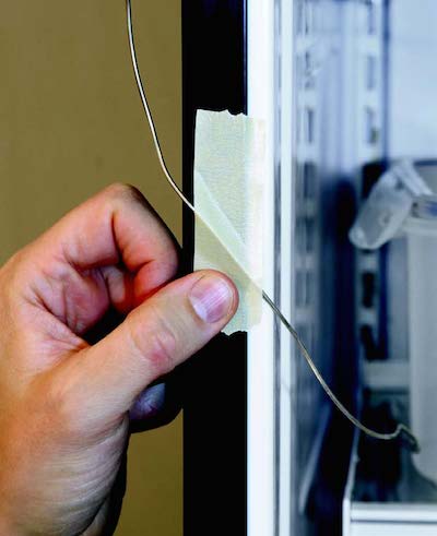

Standard refrigerators are designed to stay much colder and drier than this, so you have to tinker with them to turn them into a cave. I recommend finding a clean, small, dormitory-style mini-refrigerator at a garage sale. Then check with cheesemaking suppliers (in the Marketplace section of this magazine, p. 104) or search online for an external refrigerator thermostat. Plug the refrigerator power into the thermostat, and place the thermostat’s sensor bulb inside the refrigerator, being careful not to kink its thin tube. The external thermostat will now start and stop the refrigerator, maintaining the proper temperature. Alternatively, wine refrigerators naturally operate in the correct temperature range and can be used without modification (just take some of the measures below to protect your cheese from drying out, like my Gouda did).

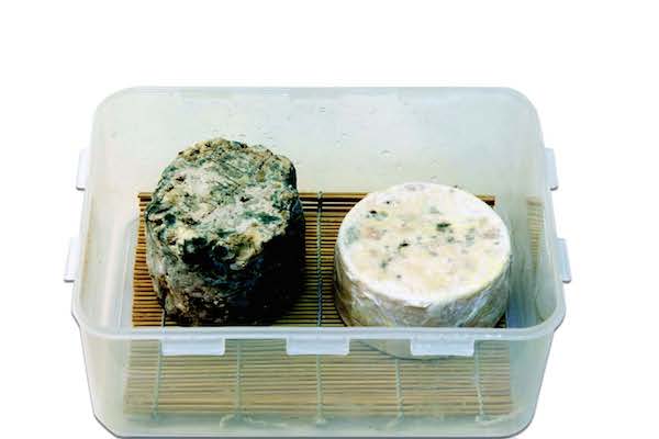

To increase the humidity, keep an open container of water or a damp towel inside the cave. Keep your cheese in a container covered by a dry towel to protect it from too much air circulation. Some styles, such as blues, bloomy rinds, and washed rinds, like a very humid environment. For these, cut a bamboo sushi-rolling mat to fit in the bottom of a plastic food-storage container. Lay the cheese on the mat, and cover loosely with the container lid (don’t seal it completely). Do not let moisture pool at the bottom or touch the cheese. To help the cheeses mature evenly, flip them over regularly.
