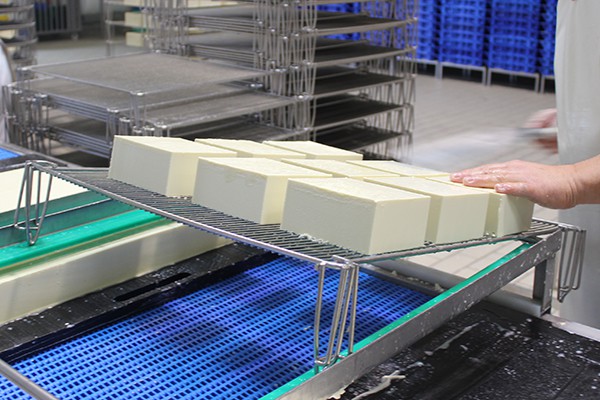

Curdless blocks of pre-cheese at Fromagerie Guilloteau
Newly formed blocks of ultrafiltered cheese at Fromagerie Guilloteau

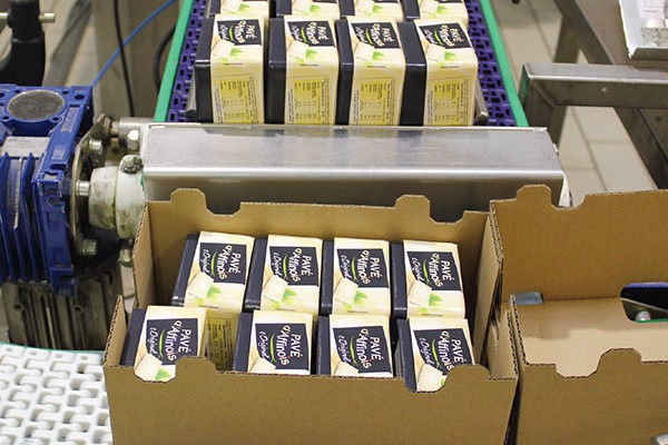

Freshly packaged blocks of Pavé d’Affinois

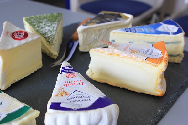

Selections from Fromagerie Guilloteau
