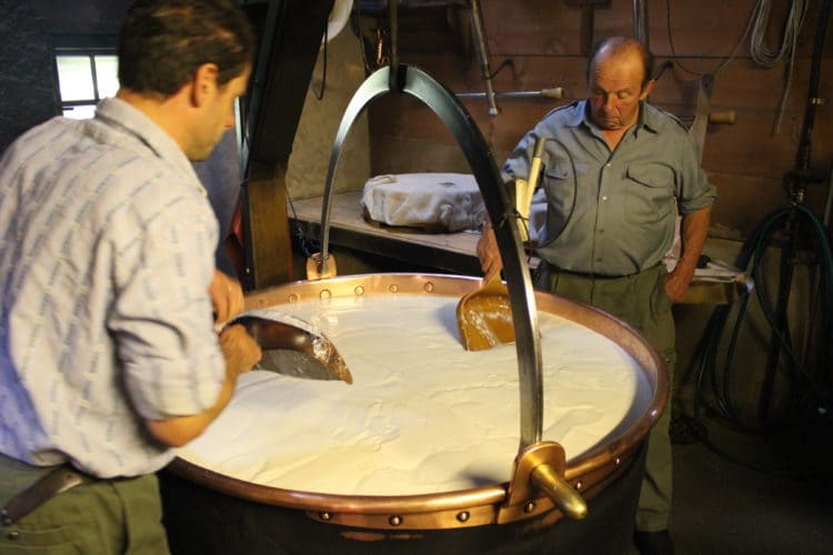

Father-and-son team Germain and Béat Piller make Gruyère cheese on an alpage near Charmey, Switzerland. Photo Credit: Molly McDonough
IN the early morning on a select few alpages dotting the hills of Switzerland’s Gruyères region, cheesemakers light a wood fire under a milk-filled copper pot. As milk turns to curd, they control the cauldron’s temperature with impressive precision by swinging it on and off the flames. Here in huts surrounded by high-altitude pastures, modern stainless-steel vats seem very far away.
