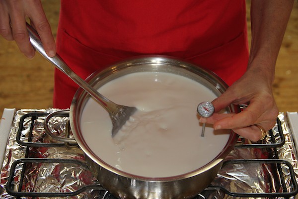

1. Pour the milk into the pot, and begin to heat and stir. Heat the milk to 90°F, stirring constantly. Remove from the heat.

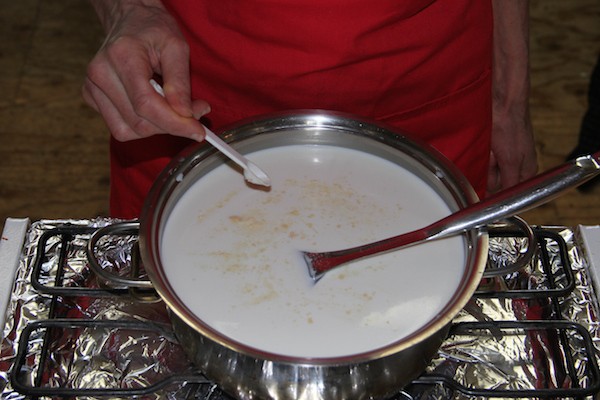

2. Sprinkle the cultures on top; cover, and wait 5 minutes. Stir until the powders are completely dissolved, usually 3 to 5 minutes. If using calcium chloride, add it now, and stir well. Then stir in the rennet and water mixture.

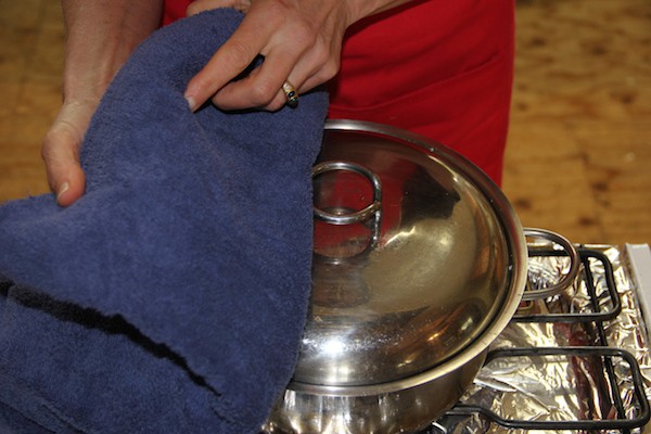

3. Cover the pot, and place it in a warm location, covered with towels so the temperature of the milk doesn’t drop below 86°F. The pot should not be disturbed during this time.

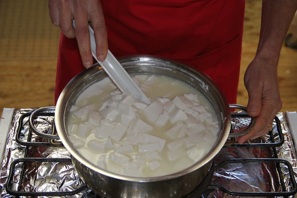

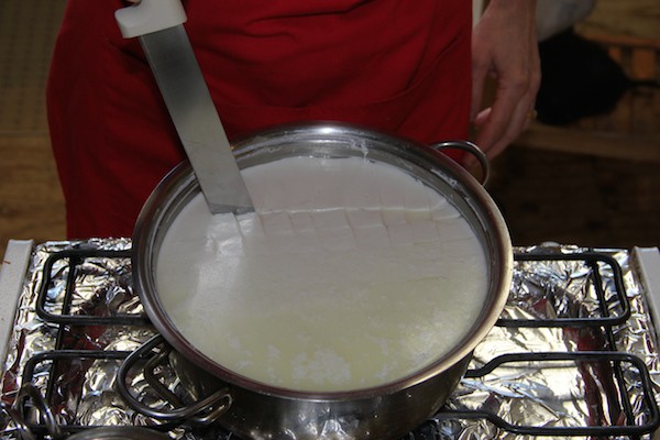

4. After 2 to 4 hours, the milk should be gelled enough so that it is easy to insert a blade along the side of the pot and pull away the curd. Cut the mass into 1-inch chunks (for medium-curd cottage cheese), cover, and let set for 10 minutes.

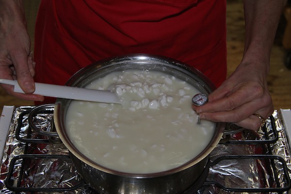

5. Place the pot on the stove or in a sink to which you can add warm water, and begin heating and stirring. You may need to be very gentle at first, depending on the milk used and the firmness of the curd. The stirring and cooking can take either 60 or 90 minutes.
6. The 90-minute method is done by adding heat and stirring incrementally. Raise the temperature 2 to 3°F while stirring; cover, and let set for 5 minutes. Repeat until 115°F is reached. For the 60-minute method, continually stir while slowly raising the temperature until 115°F is reached.

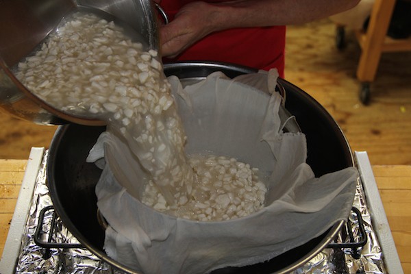

7. When the curds have reached the correct size and temperature, remove from the heat, and pour into a cheesecloth-lined colander. Rinse with cool water until the curds are cold. Drain for 10 minutes.

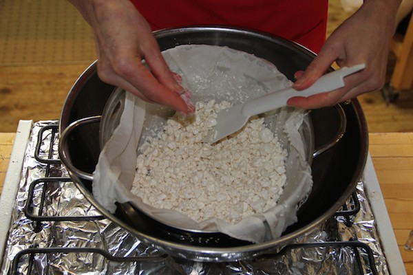

8. Add a pinch of salt, and stir. Drain for 20 to 30 minutes until no liquid can be squeezed from the cloth (squeeze gently to test; you don’t want to smash the tender curds).

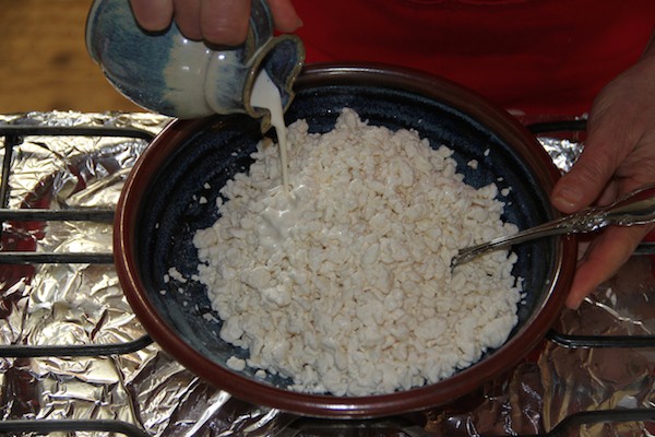

9. For a creamy texture pour the finished curds into a bowl and stir in heavy cream, with salt to taste. At this point the curds will be a little squeaky when chewed but will become more tender and quiet by the next day. Refrigerate, and enjoy for 1 to 2 weeks.
