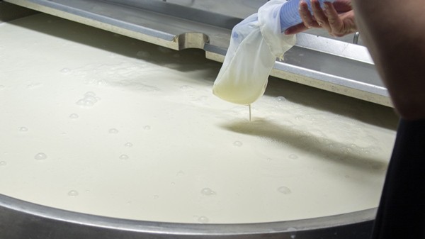

The milk is fed from the milk truck into the cheese house vats using gravity and hoses. Inside the cheese house, one end of a hose is fitted with a milk sock (to catch any debris) and the other end is ready to be connected t the milk truck hose through a port near the ceiling.
Milk Sock in Vat at Parish Hill

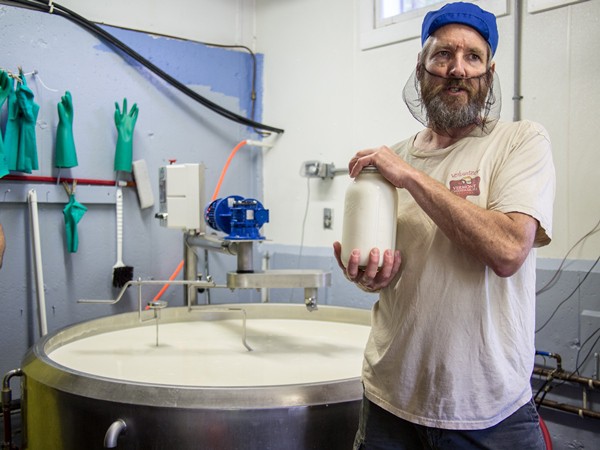

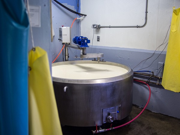

Once the milk makes it into the house, it sits in a chilled vat overnight to allow the cream to separate from the milk.
7 - vat with sitting milk
Goodnight, Milk.

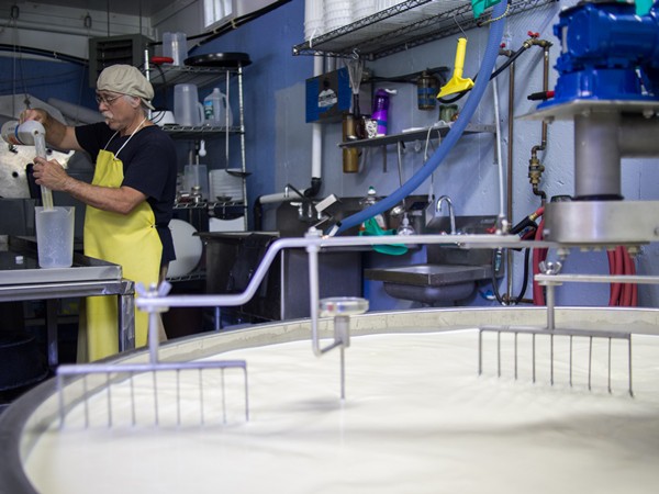

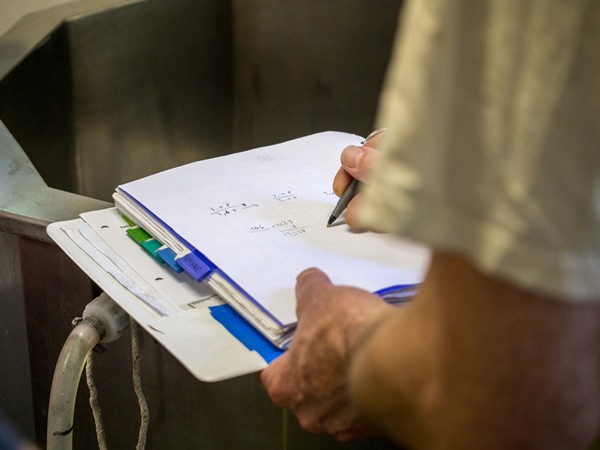

The next morning, Peter does a quick calculation to determine the volume of cream to skim off the top in order to achieve the right ratio (of cream to milk) for Idyll.
5 - cream calculation

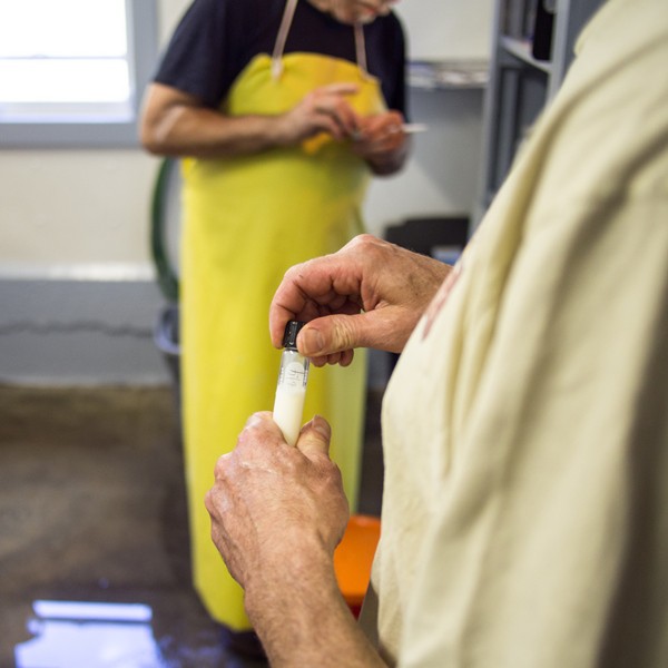

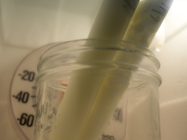

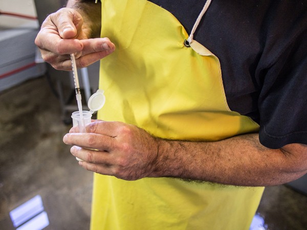

Then, the milk is ready for some testing. (This is where I remember cheese is not actually magic; there is some science too).
pouring milk into a test tube
holding test tubes for ph test
ph tester - parish hill

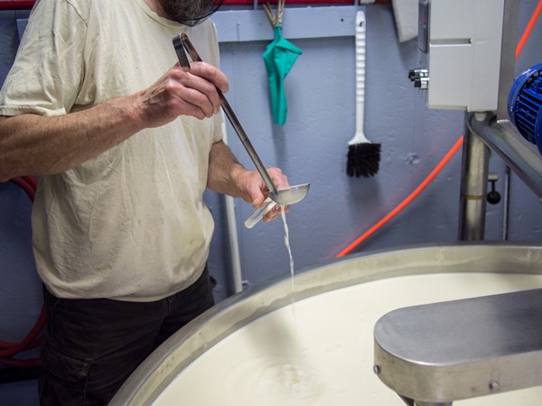

And on to the skimming!
6 - skimming cream

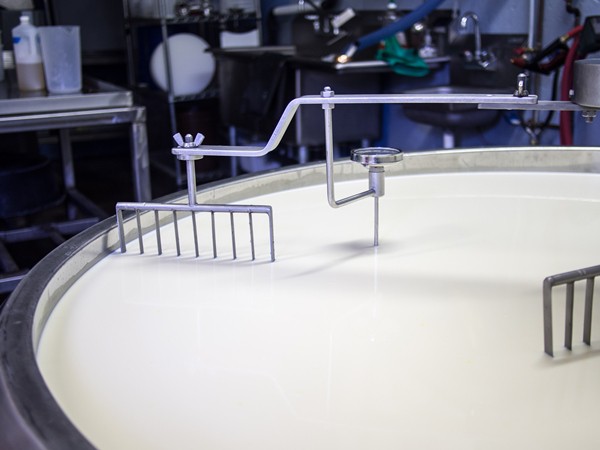

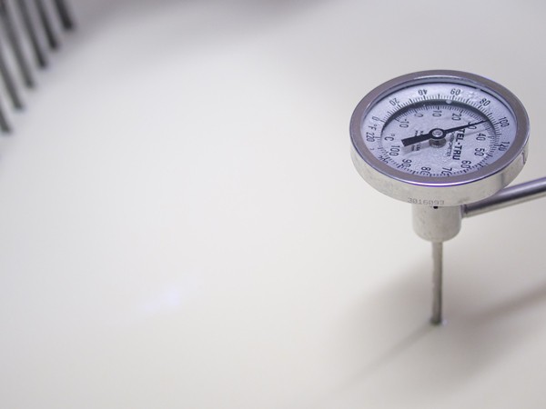

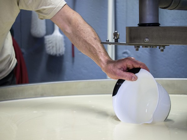

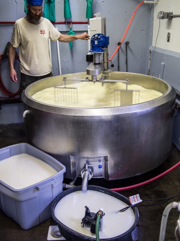

After skimming come cultures. Parish Hill proudly makes their own cultures, in the Swiss tradition, using the same milk from a select few cows in the milking herd. The cultures are introduced into the milk as the vat is heated.
8 - peter with culture
Then, it’s rennet time! The rennet is measured and mixed with water before being added into the milk.
rennet and mixing curd in a vat

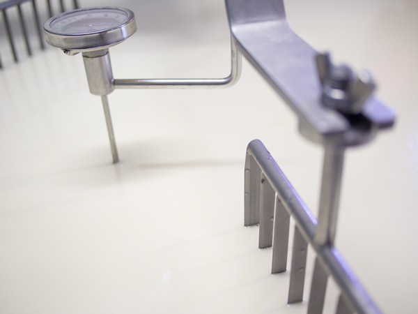

 close up vat - flocculation
And more patience.
close up vat - flocculation waiting - Parish Hill
A quick texture check.
Flocculation -Parish Hill Creamery
Flocculation!
close up vat - flocculation - Parish Hill Creamery

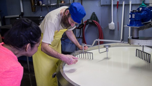

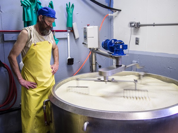

Time to (watch the vat) break up the curds.
watching curds - peter dixon

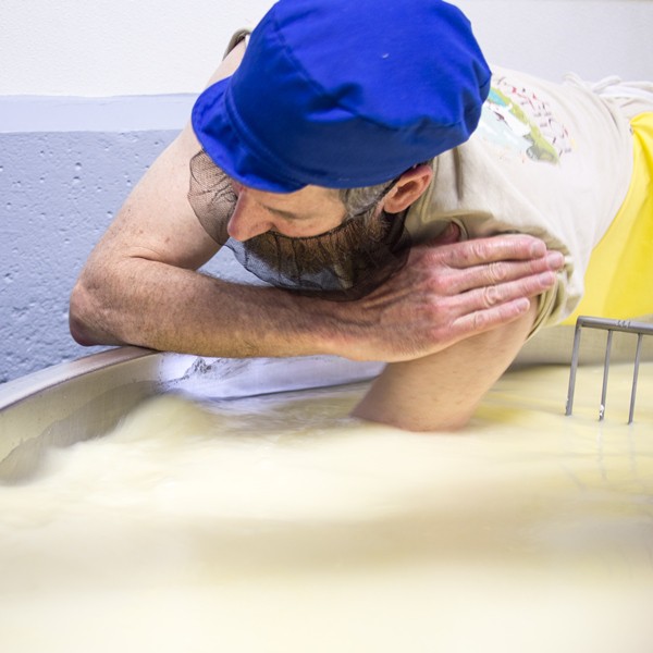

And a (nearly full-body) curd check.
peter dixon checking curd in vat

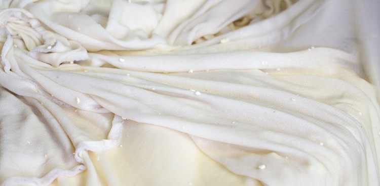

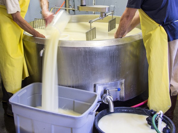

And some whey draining.
draining whey - parish hill
Drain whey, drain…
draining whey from vat - parish hill

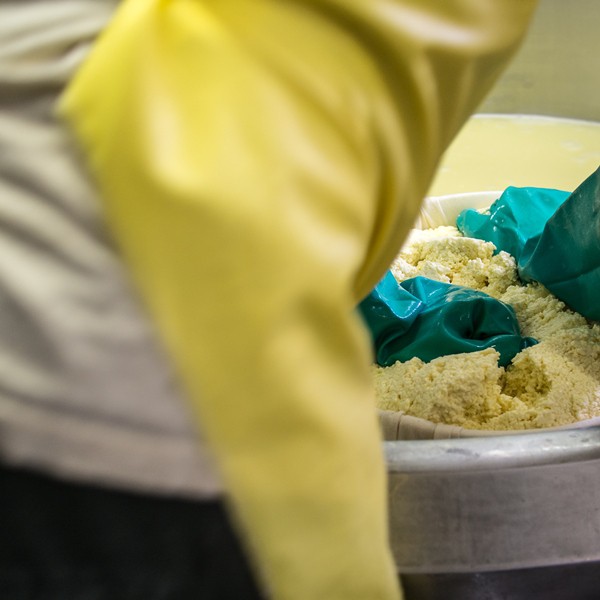

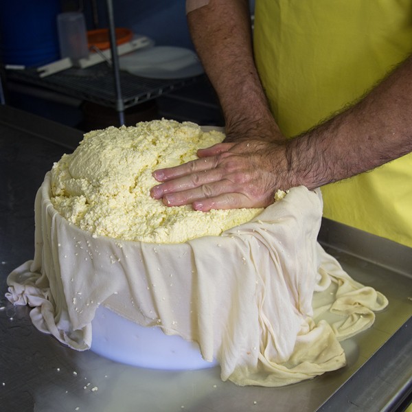

Oh, what’s that? Curd ready to be shaped?
whey shaping - parish hill

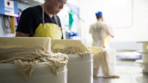

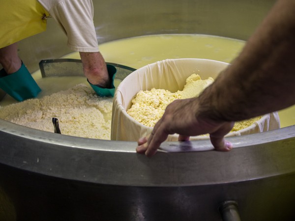

Carefully into the molds.
whey shaping - peter dixon
winnie shaping whey in mold
curds in the molds - parish hill

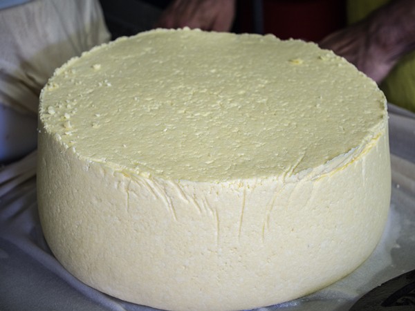

At last—cheese!
curd wheel ready to flip - parish hill
And, though I would have happily bitten into this wheel of freshly formed cheese, this guy is still a ways from being table-ready. The Idyll journey, in some ways, has just begun.
