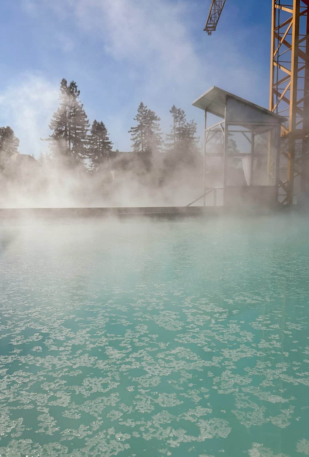

The other key ingredient is the salt used to cure Jambon de Bayonne. All Bayonne ham is made with Salies-de-Bearn salt that comes from the Adour basin. The salt is made by pumping in water from a nearby spring and heating it in salt pools to evaporate the water and produce salt crystals which are then hand harvested with nets. The salt concentration of the spring water is 300 grams per liter, 10 times higher than sea water.
The water is heated to 181.5 degrees Fahrenheit and it usually takes a month before crystals can be harvested, but the time depends on the weather conditions. The facility I visited produces 16-1800 tons of course salt and 8-10 tons of fleur de sel. Around 80 percent of the salt is used in the production of Bayonne ham.

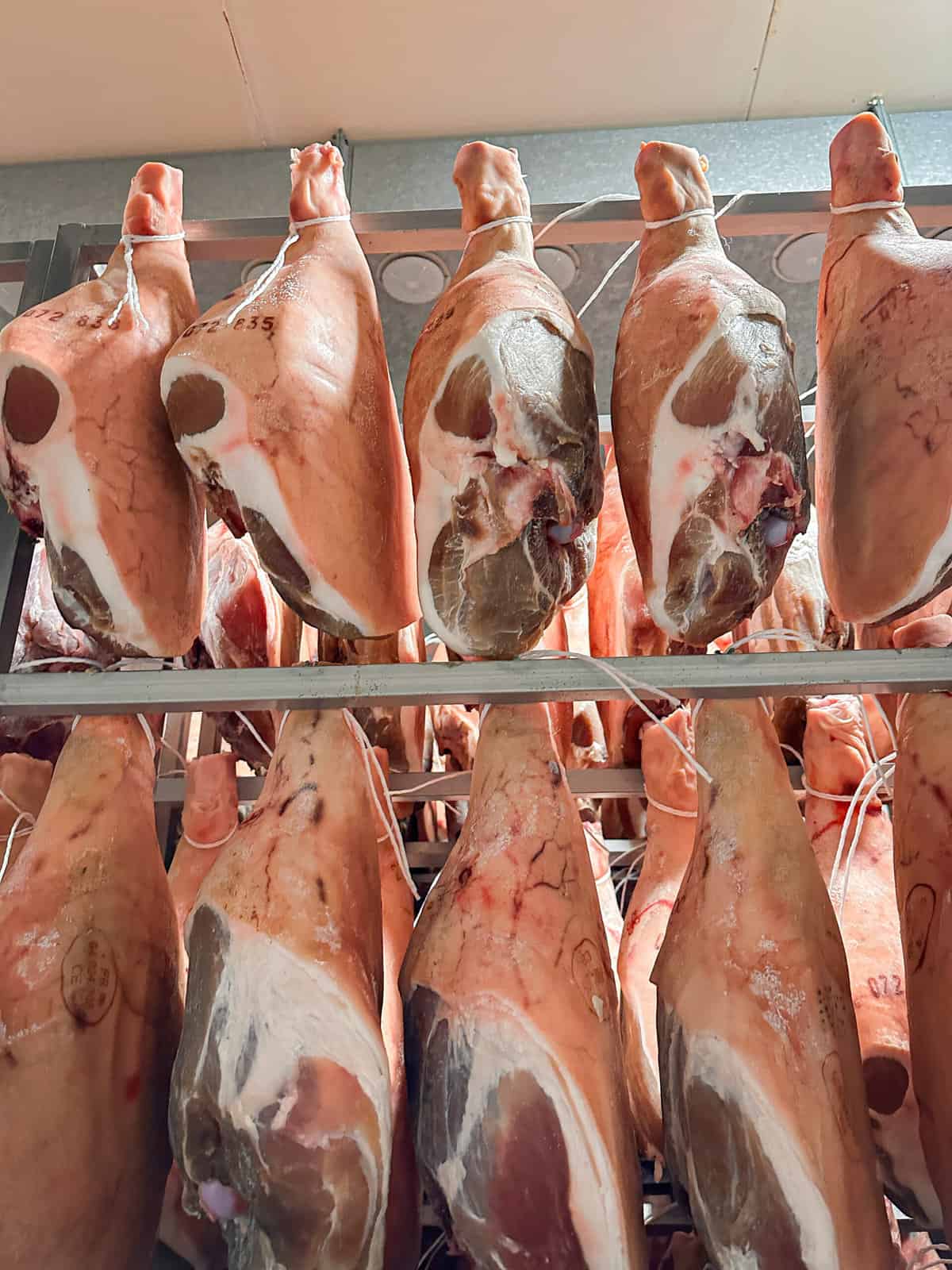

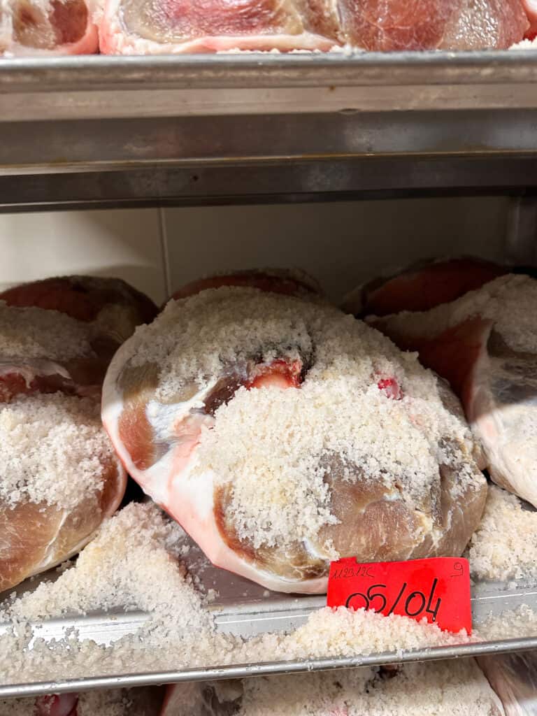

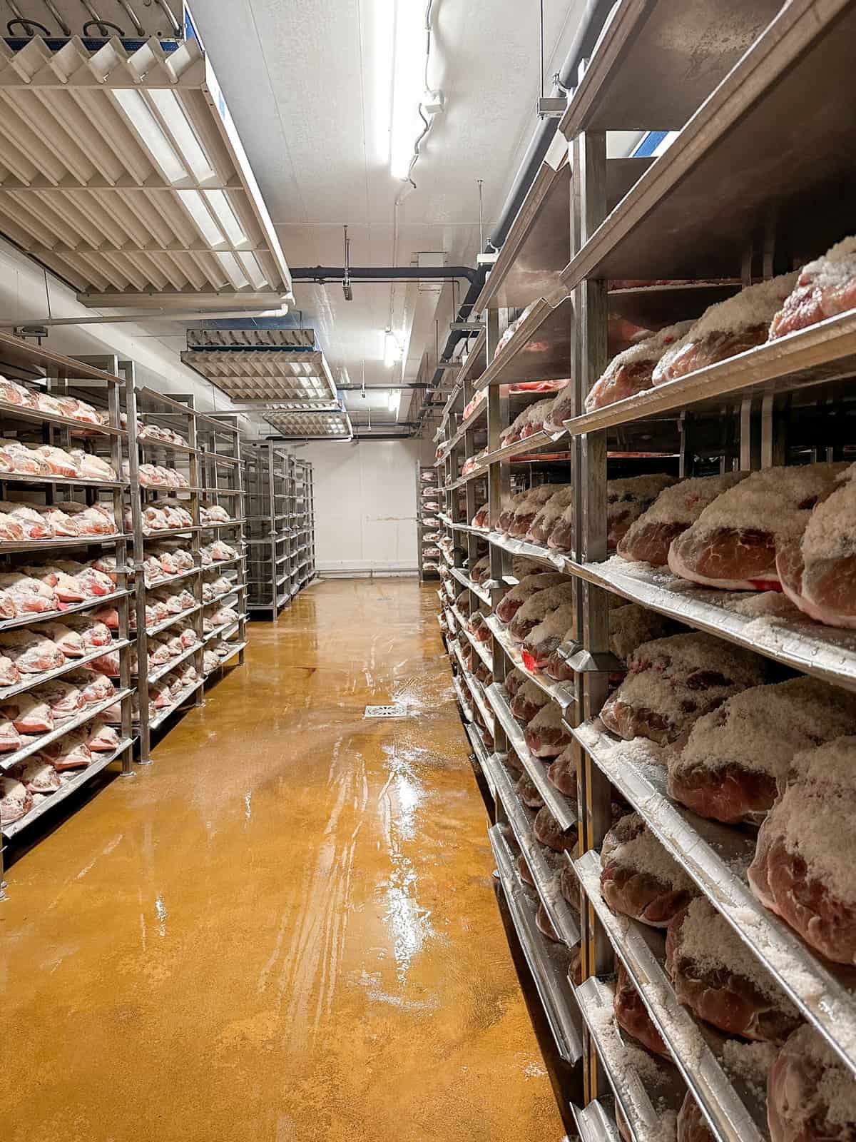

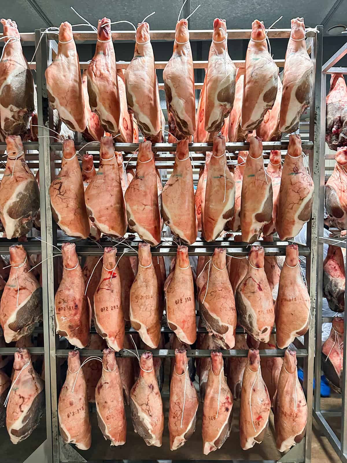

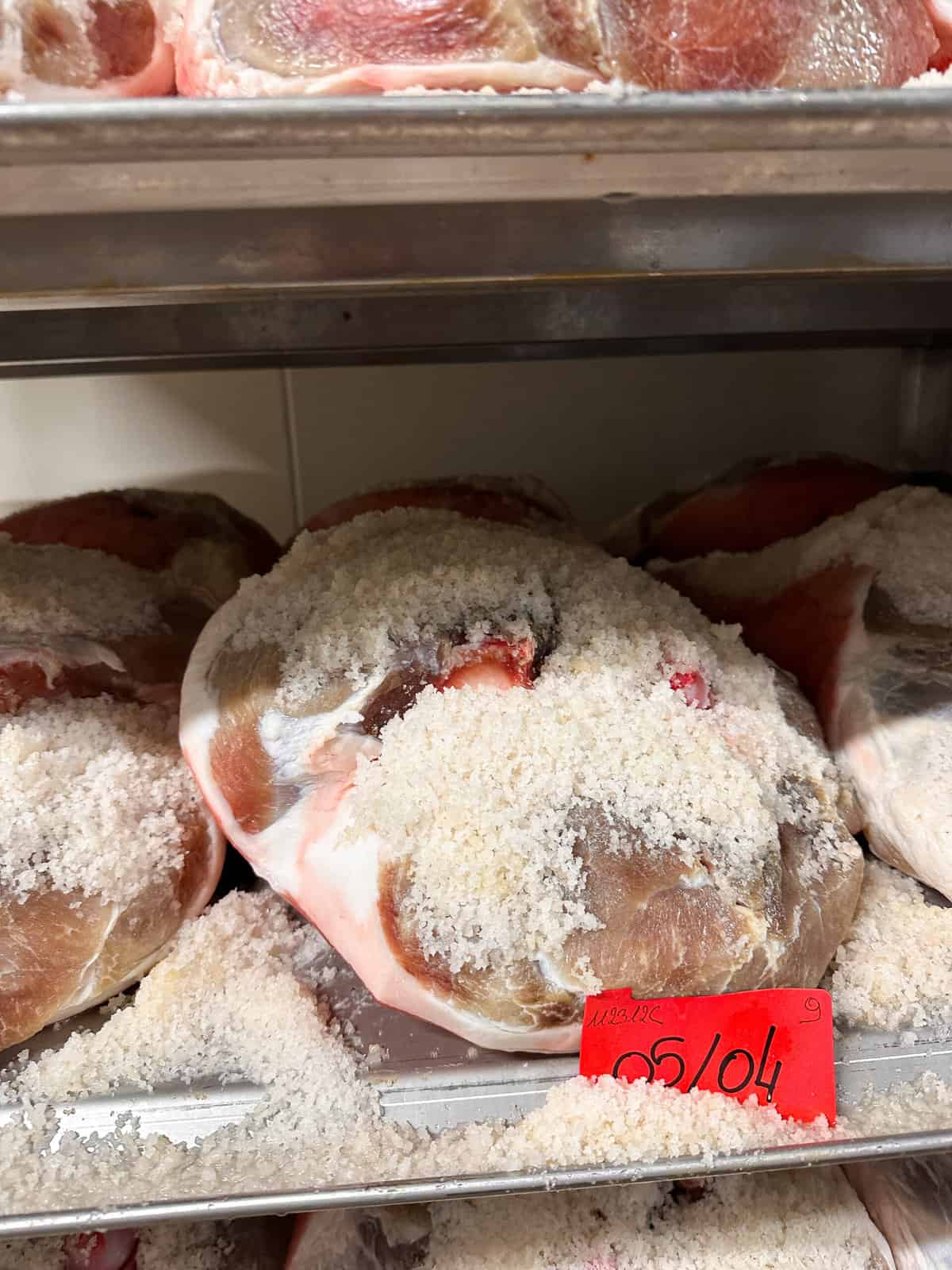

STEP 1: Salting – Whole, fresh hams are rubbed with salt from a spring in Salies-de-Béarn, which also has a PGI. Hams are salted for anywhere from 10-20 days depending on weight, and are individually probed with a salt barometer before moving onto the next step. The salt room has a humid and meaty aroma.

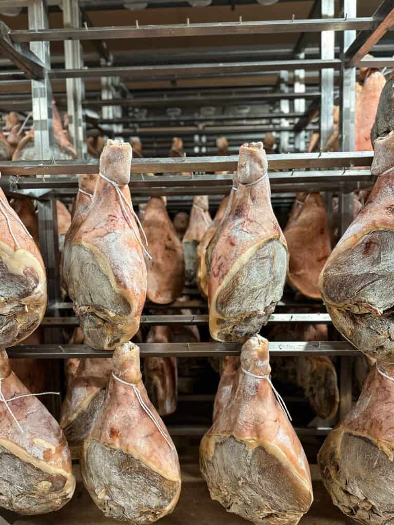

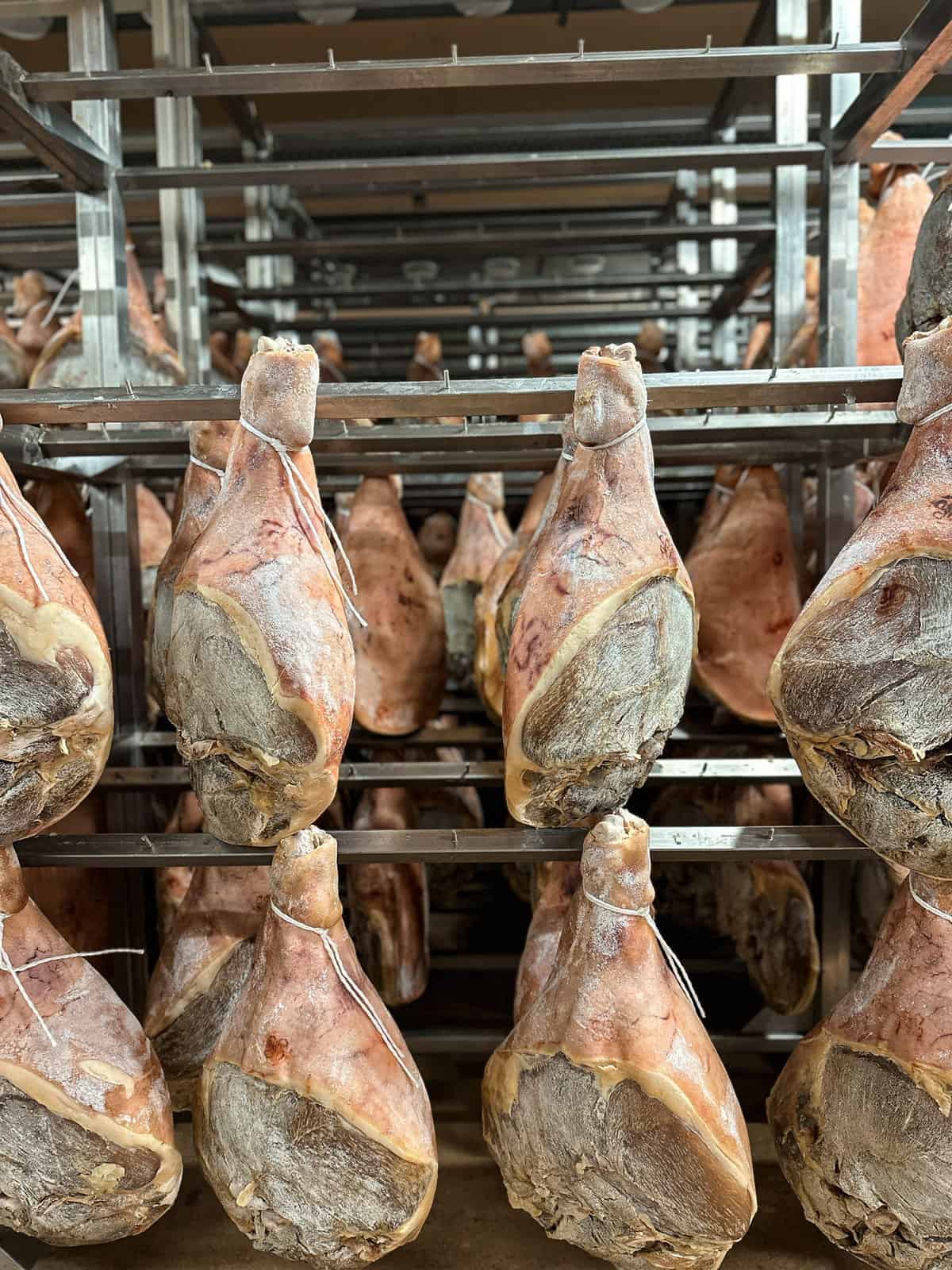

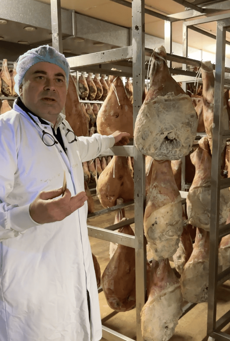

STEP 2: Resting – The hams are hung in a resting chamber, known as a souillarde (regional term for a back kitchen), which allows winter conditions to be imitated. This first room is cool with lots of airflow. The goal of this stage is to stress the ham to lose as much moisture as quickly as possible.
STEP 3: Drying – Next hams move to the drying room. The main difference between this stage and the previous stage is the temperature, humidity, and airflow conditions of the room. Each producer has its own special formula of conditions to create the perfect Jambon de Bayonne.

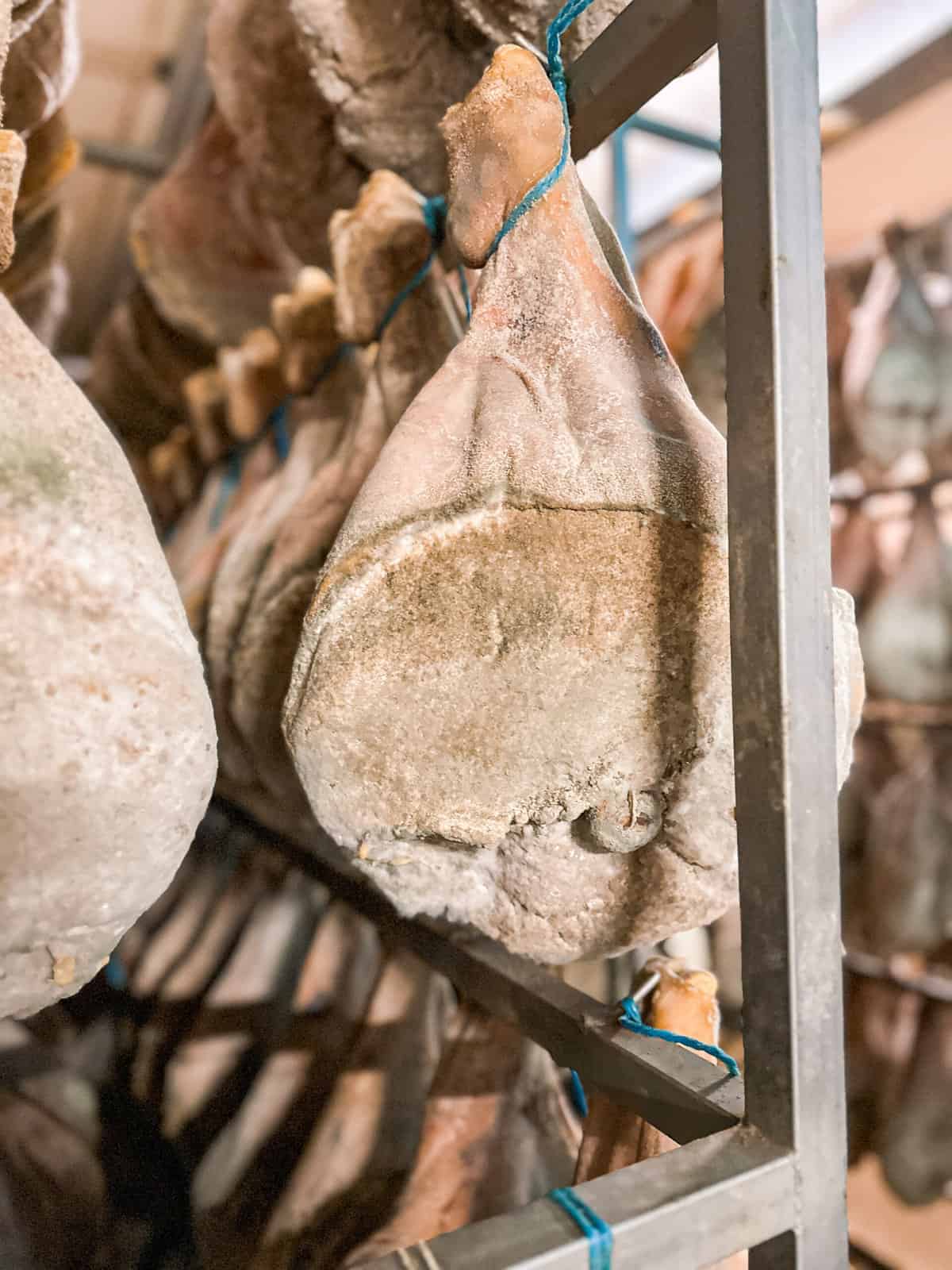

STEP 4: Pannage – Pannage is a process in which hams are coated with a mixture of lard and Italian rice flour. It moderates the rate at which the ham dries through the long maturation period. The idea is to protect the meat from too much humidity loss. In the plant we visited they said they used to do this step with a machine, but went back to doing it by hand to increase control. The skill of the ager is to know when, where, and how much of the coating to apply to the ham.

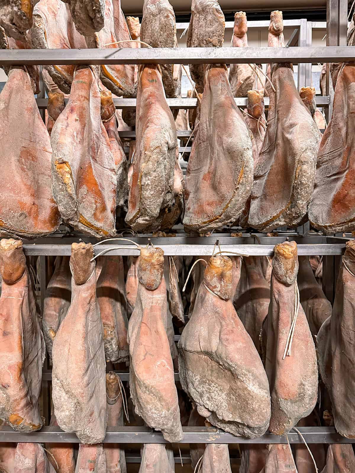

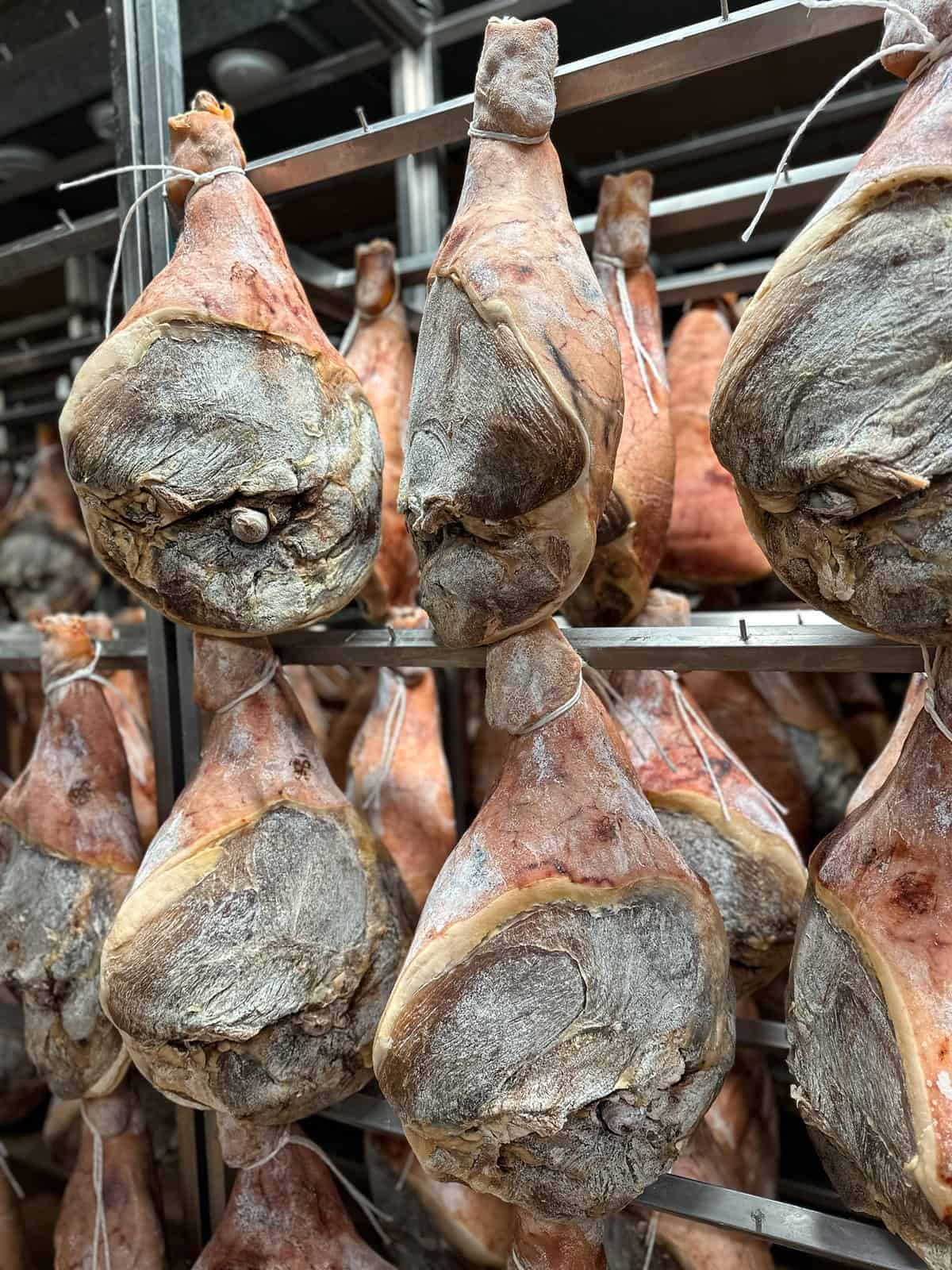

STEP 5: Maturing – This is the final aging stage where the ham will develop its flavor, aroma, and characteristic red/pink color. Again, they are paying close attention to the moisture content of each ham to determine when it is ready. The plant we visited weighed shelves daily to keep track of moisture content. From start to finish the ham will lose 30 to 35 percent of its weight as it dries out. Some other producers may use time to determine when to pull a ham, but our guide felt moisture content was a more precise way to ensure a quality product.

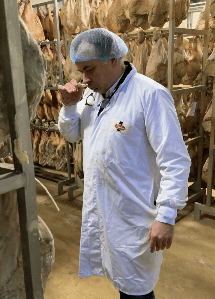

STEP 6: Probe Testing – Each ham is tested by an expert who will grade it and give a final approval. Testers use a small probe made of bone to pierce the ham, then smell the bone to determine the aroma and qualities. This is how they ensure no hams have gone bad throughout the aging process. In the facility we visited the probe was made of horse bone, but our guide said any type of bone would work but that it must be made of bone because bone does not have a smell.
