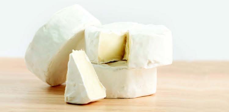

Legend has it that camembert was first made in the 1790s by a farmer’s wife named Marie Harel, who learned the recipe from a priest from Brie. While these origins are disputed, the delectableness of the cheese is not. And today, with some care and a few pieces of equipment, you can make camembert in your own home.
The only differences between camembert and brie are 3°F during acidification (which occurs at 85°F for camembert and 88°F for brie) and the shape of the molds (4 inches for camembert and 7½ inches across for brie). Traditionally, both cheeses are made from whole milk, but for richer versions you can double the amount of cream.
Once you’ve successfully made a camembert, you can start experimenting with brie or Saint André. While brie requires a differently sized mold, you can use painter’s tape to stack two camembert molds to fill in as the one, taller mold that’s needed for Saint André. Then just fill the double-height mold with twice as much curd as you’d need for camembert.

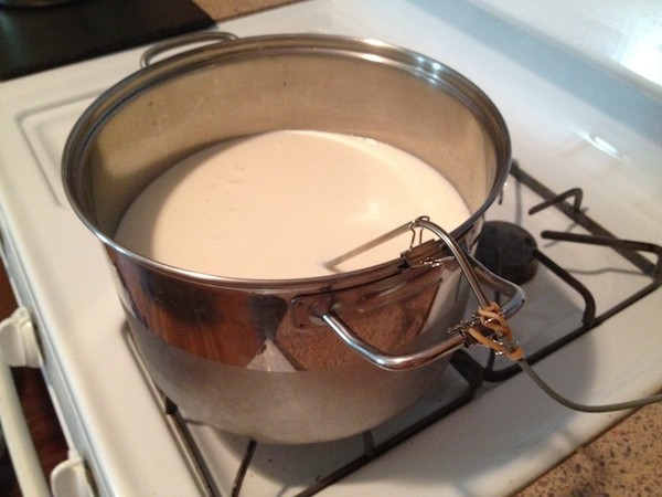

Pour the skim milk and heavy cream into the pot, and mix well. Slowly warm the milk to 85°F. Sprinkle the mesophilic II culture and Penicillium candidum powder over the milk, and let stand 5 minutes.

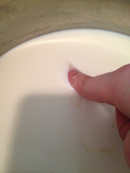

Check for a “clean break” by inserting the clean handle of a spoon or a finger into the curd at a 45-degree angle. If the curd splits apart in a clean line, you have achieved a clean break. If not, let it stand for another 10 minutes or more, until a clean break is achieved.

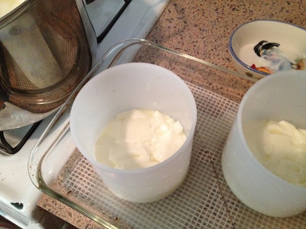

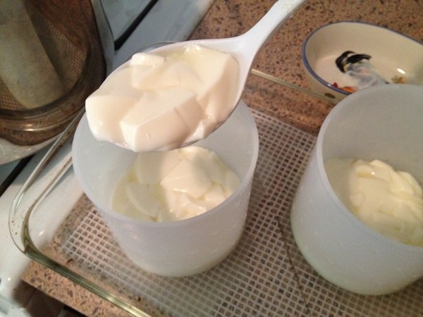

Set up two molds on top of two draining mats in a sterilized location at room temperature (68 to 72°F.). Use a measuring cup to discard whey from the pot, until curds are just below the surface of the whey. Use the skimmer to fill molds with curd. Let stand 2 hours.
Step 9

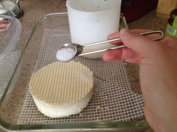

Remove the cheeses from the molds, and sprinkle the top of each with ½ teaspoon salt. Flip and repeat on the other side. Place the cheeses in ripening containers on mats in an environment where you can keep them for 4 to 5 weeks, and where the temperature stays between 50 and 55°F. On a daily basis, empty any water that has collected under the mats and flip the cheeses. When mold completely covers each (in 12 to 20 days), wrap each in cheese paper and move to the cave for continued aging. The cheeses will begin to soften at 20 days, and they are ready to eat after 4 to 5 weeks.
- Step 2. Slowly warm the milk to 85°F.

- Step 5. Check for a “clean break” by inserting the clean handle of a spoon or a finger into the curd at a 45-degree angle
- Step 8. Use the skimmer to fill molds with curd
- Step 8. Let the curd drain for 2 hours before flipping
- Step 10. 10. Remove the cheeses from the molds, and sprinkle the top of each with ½ teaspoon salt
