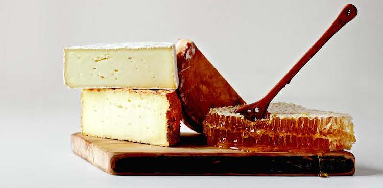

At Murray’s, Kinderhook Creek resides in the bloomyrind cave, an incubator for delicate soft-format cheeses. A pure sheep’s milk wheel, Kinderhook Creek develops a captivating texture as it ages: Dense, pristine white paste with a silky creamline that oozes like lava beneath the rind. After several weeks, the 14-ounce disc becomes soft and spreadable. Tangy, buttery notes dominate its flavor profile. Hints of fresh radish, chive, and grass follow, with strong mushroom characteristics in its rind.

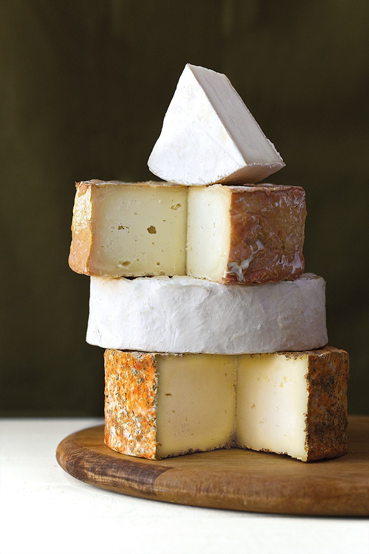

culture's summer 2014 centerfold cheese: Fromage a trois, Kinderhook Creen, Hudson Flower, and C Local
From top, Kinderhook Creek, C Local, and Hudson Flower, available for purchase through our summer centerfold offer with Murray’s Cheese.

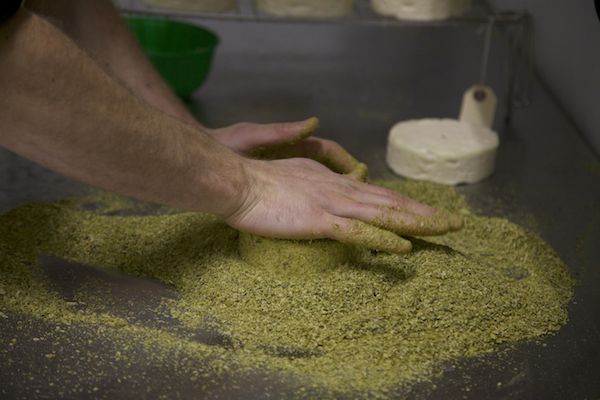

Murray's Cheese making Hudson Flower
Dehydrated hops are blended with rosemary, lemon thyme, and chervil to form a kind of potpourri that coats Hudson Flower.

In 2013, Kinderhook Creek inspired another spin-off: Hudson Flower, loosely based on the herb-covered Corsican Fleur du Maquis cheese, also known as Brin d’Amour. In a quest to flavor Kinderhook Creek’s earthy youngest sister, Ralph experimented with over 25 varieties of hops before finally settling on Ahtanum and Czech Saaz for their fruity balance. Dehydrated hops are blended with rosemary, lemon thyme, and chervil to form a kind of potpourri that coats the cheese.
