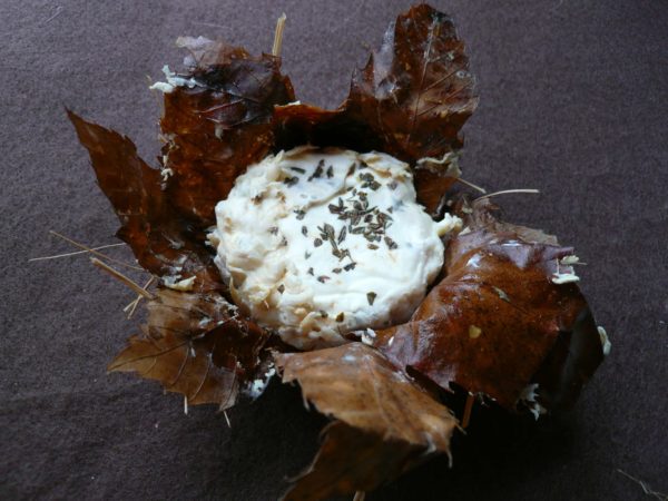

Faster starters are a cost-effective means for reducing the time it takes to make cheese (think five-hour commodity cheddar now made in three hours). However, this new timetable does not suit every cheesemaking recipe. There are traditional cheeses that require a slow build of acid to achieve specific textures and flavors, Banon and traditional English Cheddars, for instance.
